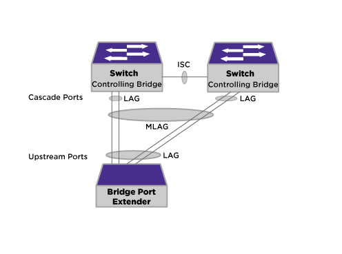

For added resiliency and redundancy, the VPEX architecture allows you to form an extended bridge using multiple controlling bridges (CBs).
When using MLAG, you must run LACP on the CB MLAG cascade ports.
